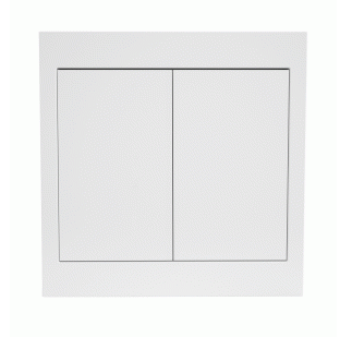

kaads Posted May 24 Share Posted May 24 (edited) tev vajag un vai esošā slēdža vietā iebāz FW raidītāju un piekonektē slēdzi vai pulti. vai arī abus, un nosvied kur vajag. Slēdzis barojas no tabletes. Kalpo gadus 4 vai 5. https://www.elektrika.lv/lv/gudra-maja/fwave Edited May 24 by kaads 1 Link to comment Share on other sites More sharing options...

Fēniks Posted June 2 Author Share Posted June 2 Tika iegādāts biedra kaads ieteiktais variants no elektrika. Link to comment Share on other sites More sharing options...
