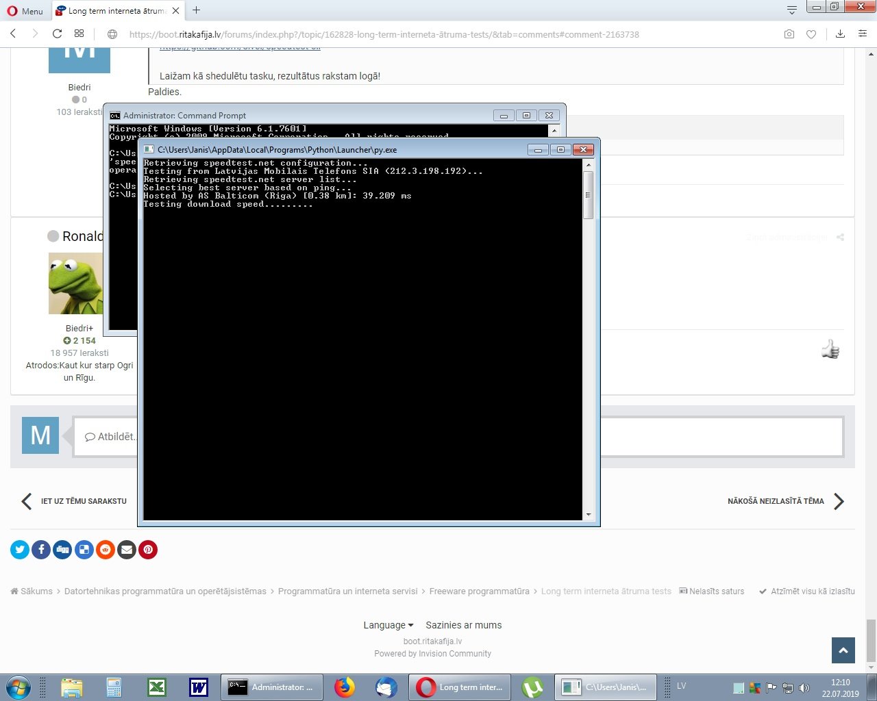

matrixxxx
 Ronalds
Tu ar Linux veidīgajiem strādā ?
Atvainojos, esmu baigais zābaks/lāme.
Nezinu, kas ir ICQ, IRC arī sveš, DC++ laikos vēl autiņos čurāju, bet torrentus dabūju mācīties no jauna :)
Man parāda logu, testē ātrumu, un pēc tam pazūd.
Logs:
PS., pa lielam laikam jau PO. Ātrāks būs tikai LTK, ar ievilkšanas maksu uz 10.k eur.

AndrisBB
uzinstalē ar
pip3 install speedtest-cli
pēctam
andris@precision ~ $ speedtest-cli
Retrieving speedtest.net configuration...
Testing from BT (81.129.169.61)...
Retrieving speedtest.net server list...
Selecting best server based on ping...
Hosted by Hub Network Services Ltd (Newport) [30.71 km]: 39.832 ms
Testing download speed................................................................................
Download: 31.86 Mbit/s
Testing upload speed......................................................................................................
Upload: 0.46 Mbit/s
Vai kautko tādu ko var logot csv failā
andris@precision ~ $ speedtest-cli --csv >> log.csv
5833,Hub Network Services Ltd,Newport,2019-07-22T17:33:46.207353Z,30.71304151237554,28.676,31799337.577744976,450478.76145005977,,81.129.169.61
