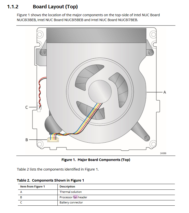

ivo 568 Posted March 25 Author Share Posted March 25 Pirms 1 minūtes , jacobs teica: Izpūšu kārtīgi Ko tur var izdarīt vispār? Ventilatora nav Quote Link to post Share on other sites

Lcs006 43 Posted March 25 Share Posted March 25 Pirms 5 minūtēm , ivo teica: Ventilatora nav ir https://www.mouser.cn/datasheet/2/612/NUC8i3BE_NUC8i5BE_NUC8i7BE_TechProdSpec-1664404.pdf 1 Quote Link to post Share on other sites

ivo 568 Posted March 25 Author Share Posted March 25 (edited) Izjaucu, tikko, ventilators ir, bet iespējams, ka šis nemaz negriežas. Jo putekļu tur tikpat kā nebija. Edit: nē, tomēr darbojas gan Edited March 25 by ivo Quote Link to post Share on other sites
