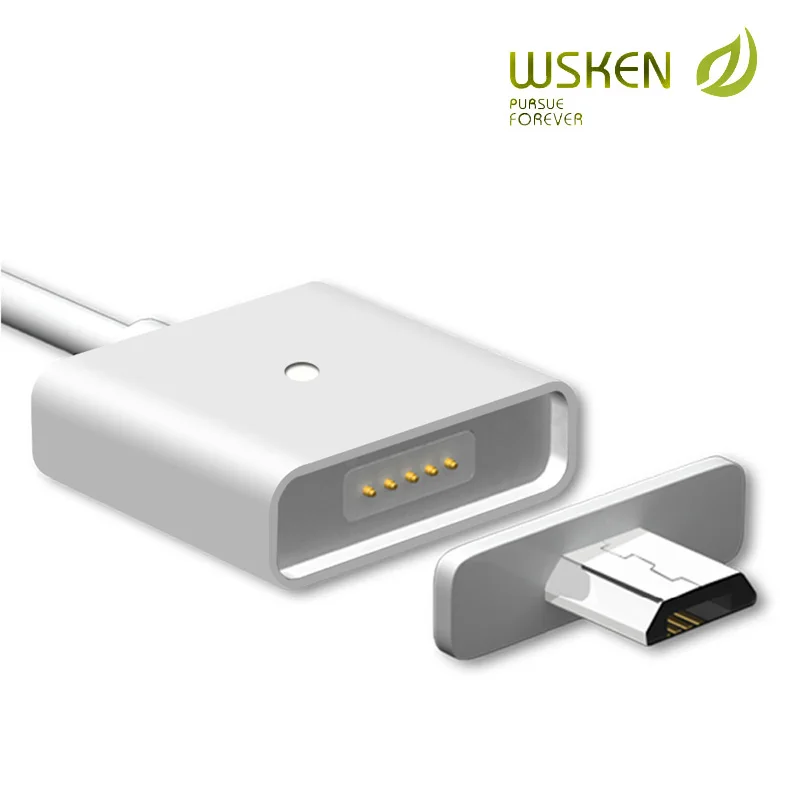

MartiniB 99 Posted May 10, 2017 Share Posted May 10, 2017 lai nechakareetu MicroUSB ligzdu rekomendeeju magneetisko zheel tikai lenjkjveidiigu variantu naff Quote Link to post Share on other sites
