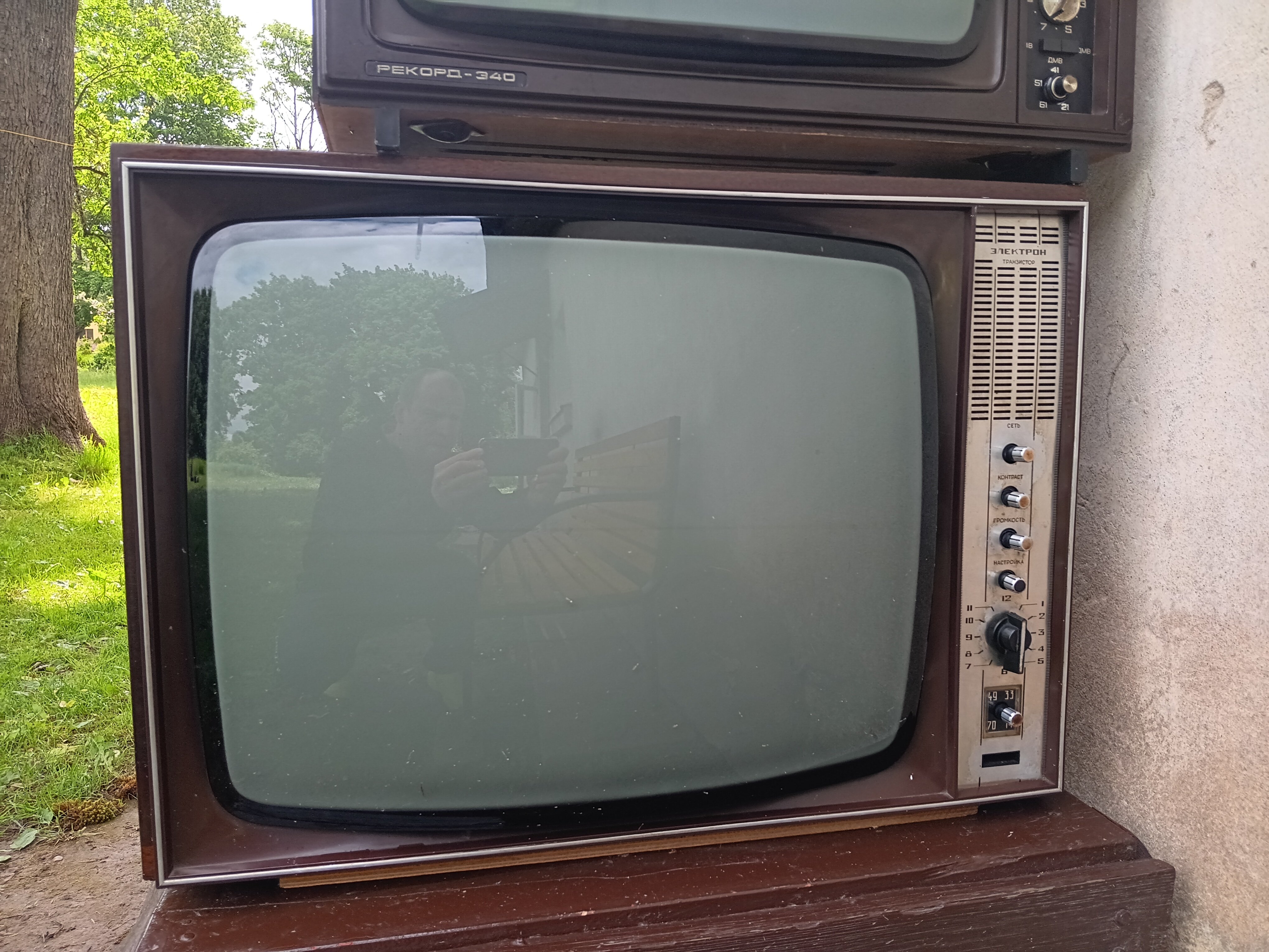

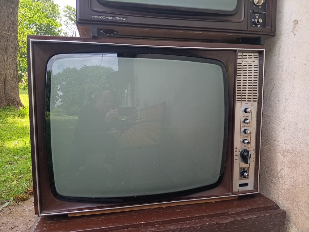

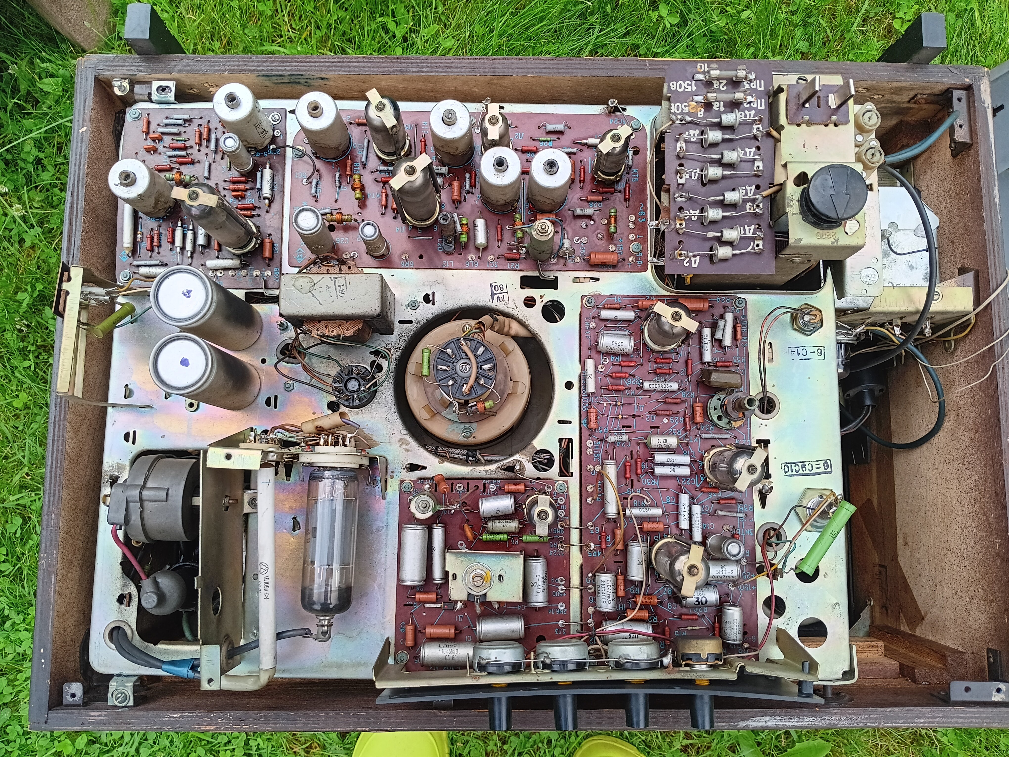

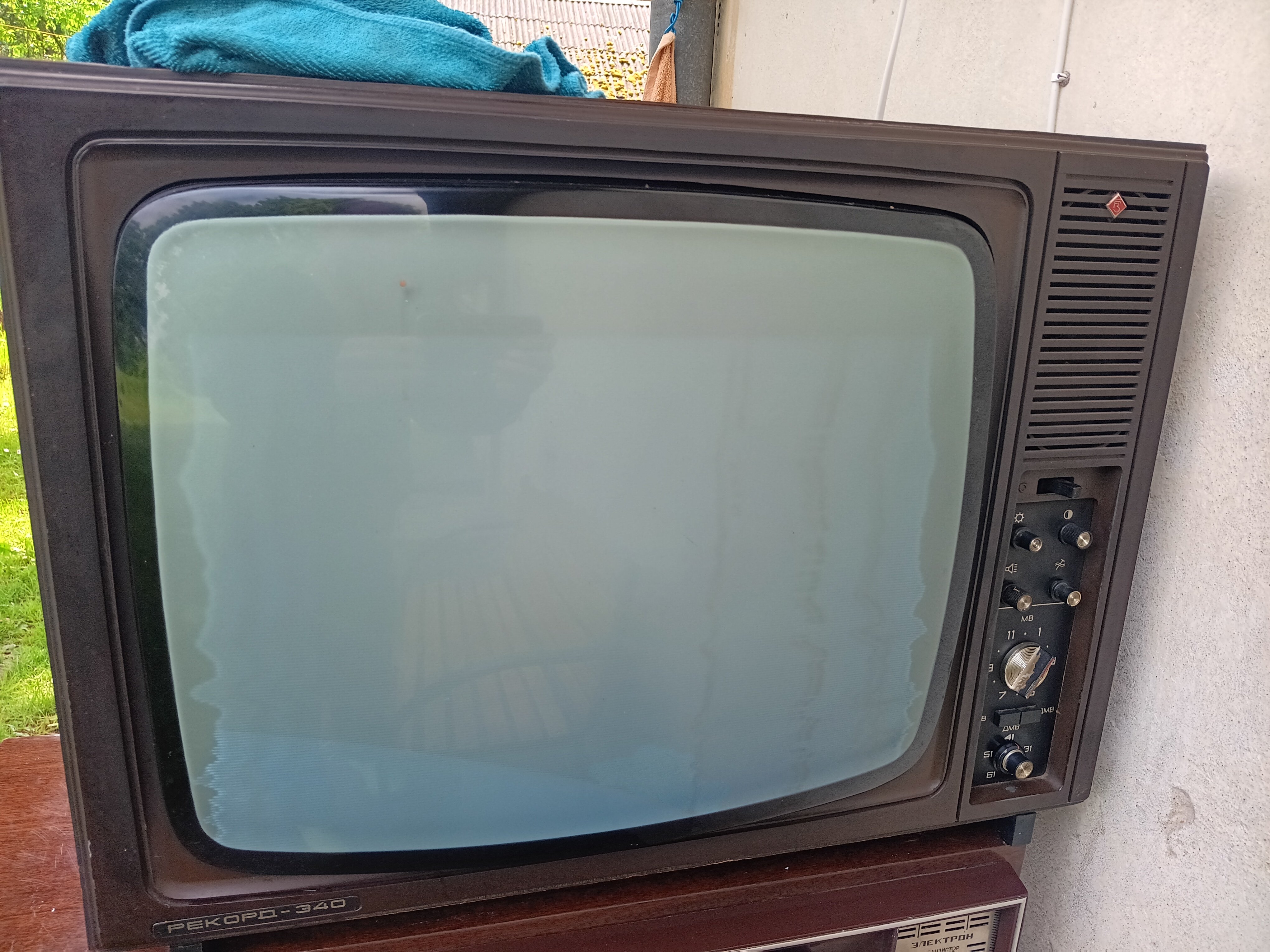

Māšuks Posted June 24, 2025 Share Posted June 24, 2025 (edited) Sveiki! Vai kādam vel kur saglabājušās lampas priekš šiem vecajiem TV ? Edited September 3, 2025 by Māšuks 1 Link to comment Share on other sites More sharing options...

Māšuks Posted June 24, 2025 Author Share Posted June 24, 2025 (edited) uz kineskopa 1975 gads Edited September 3, 2025 by Māšuks Link to comment Share on other sites More sharing options...

138 Posted June 24, 2025 Share Posted June 24, 2025 Pirms 21 minūtēm , Māšuks teica: uz kineskopa 1975 gads Šito ražoja no 1972. https://rw6ase.narod.ru/index1/tw/tw_chb_stand/elektron216.html Otru no 1980. https://rw6ase.narod.ru/index1/tw/tw_chb_stand1/rekord340.html Abi melnbalti, tātad laikam mazāk degoši? Link to comment Share on other sites More sharing options...

inteens Posted June 24, 2025 Share Posted June 24, 2025 (edited) Rekordam interesanta modifikācija uztaisīta augstspriegumam, demfera lampas vietā diožu stabs KЦ109. Tās lampas samērā bieži kūrās nost. Edited June 24, 2025 by inteens Link to comment Share on other sites More sharing options...

strawberry8 Posted June 25, 2025 Share Posted June 25, 2025 Lampas ir paris kastes un UKR ari var dabut Varetu but tie papira kondensatori . Lampas medza degt un ekrans nespid ja kads kondensators bojats 1 Link to comment Share on other sites More sharing options...

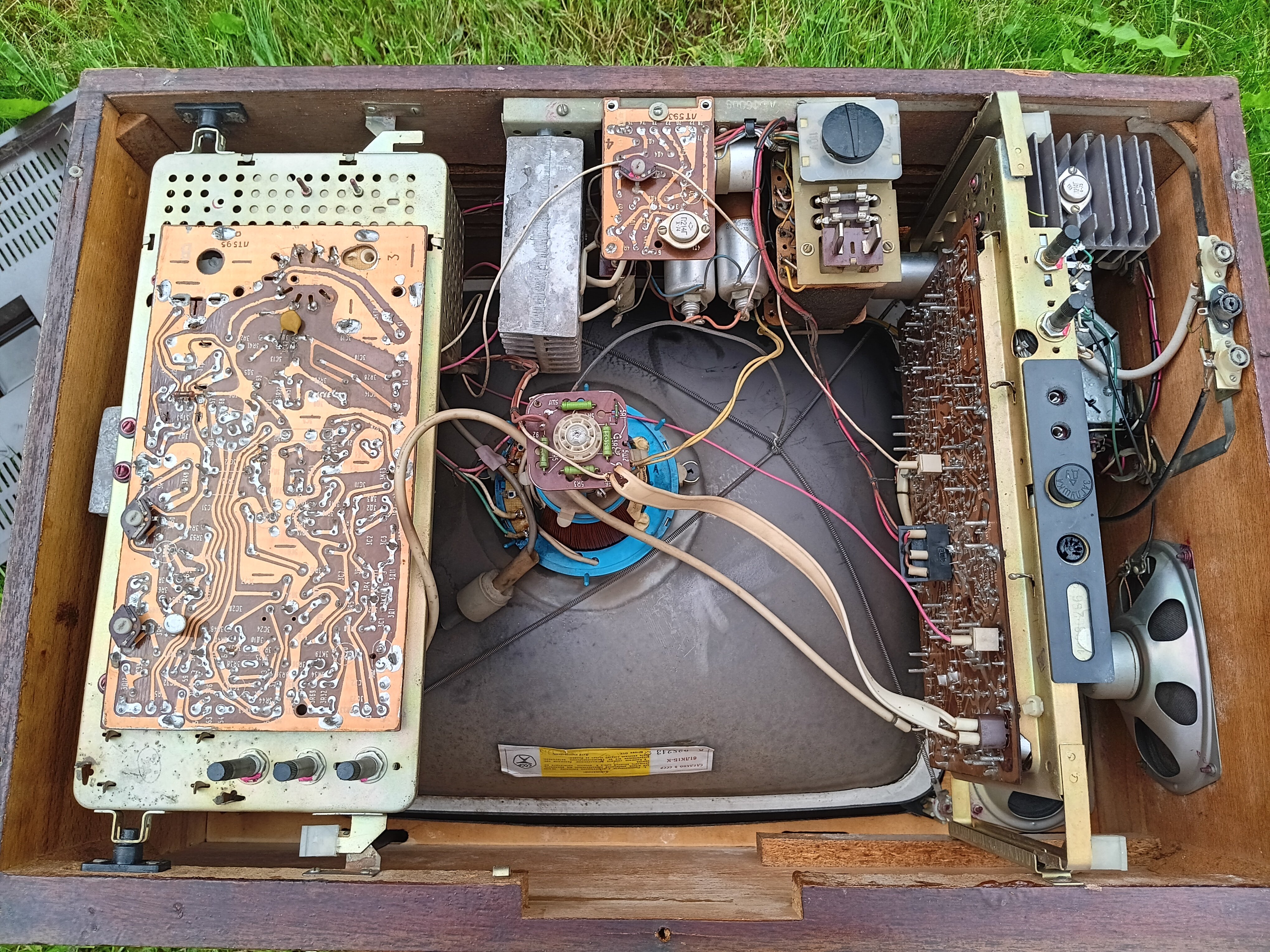

Rudiger Posted June 25, 2025 Share Posted June 25, 2025 Tas apakšējais TV ir Электрон Транзистор un tajā nav nevienas lampas, izņemot kineskopu. Kādreiz tāds bija, neko labu par to neatceros, vienīgi strāvas patēriņš daudz mazāks kā lampiniekiem. 2 Link to comment Share on other sites More sharing options...
