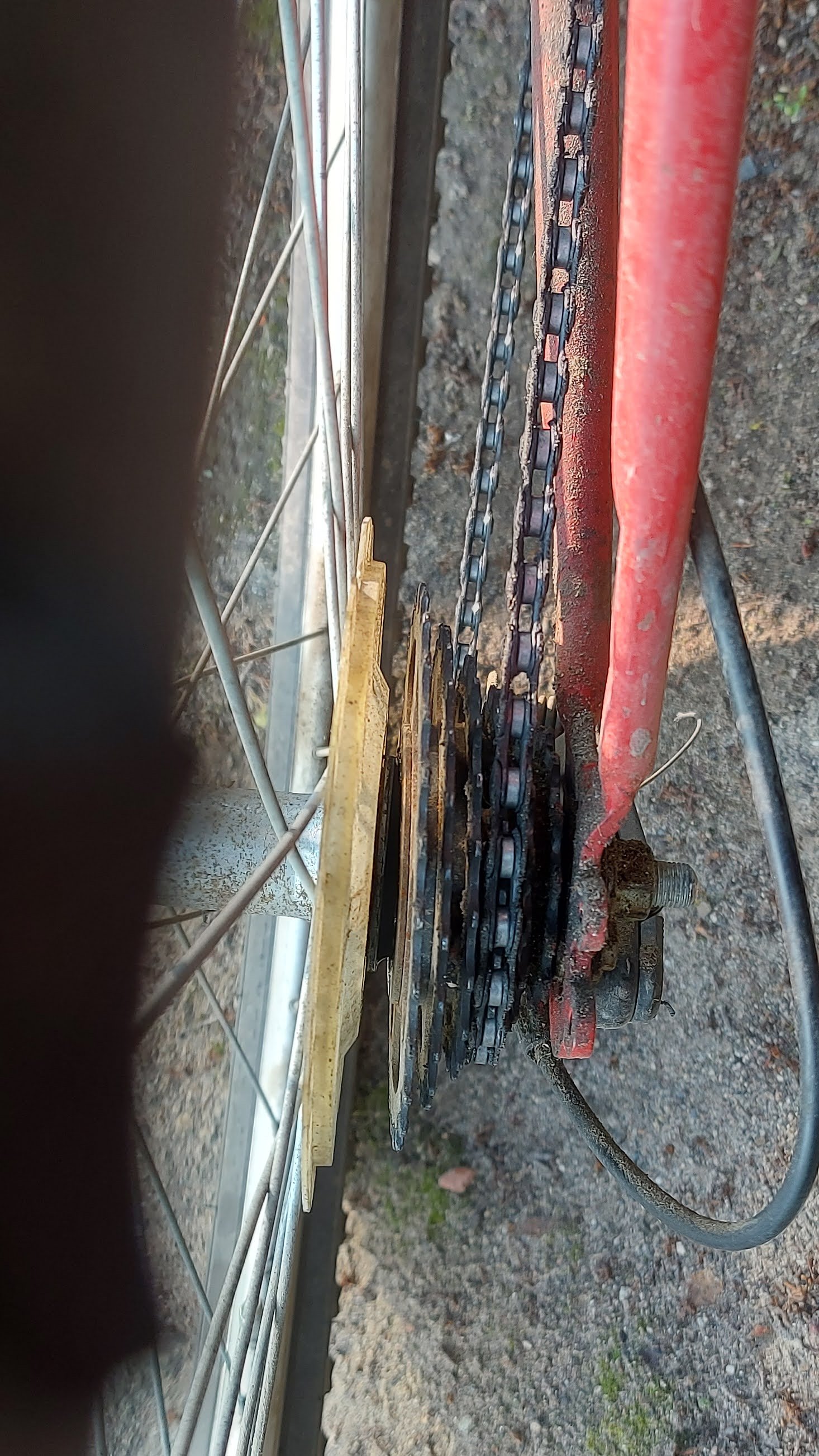

raivix95 Posted June 10 Share Posted June 10 Šodien 2km no mājām izjuka kasete. Brīnumainā kārtā dabraucu līdz galam. Divi griezieni pa tukšo, viens uz priekšu 1 Link to comment Share on other sites More sharing options...
Aigus Posted June 10 Share Posted June 10 Izskatās interesanti 😀 Gultņi sadalījās reizinātājos un izbira? Link to comment Share on other sites More sharing options...
osscar Posted June 10 Share Posted June 10 (edited) Tas ir freewheel? Visticamāk ass saliekta..salauzta..uzreiz mainīt uz kasetes rumbu...ja 26 rats, kaut kāds nexelo no zzk ap 50 eur viss rats ar rumbu Edited June 10 by osscar Link to comment Share on other sites More sharing options...
138 Posted June 10 Share Posted June 10 Hesus, kas tas par deviņdesmito Hi Ten rāmi. Nē nu respekt, ka tik ilgi izvilcis. Pirms 28 minūtēm , osscar teica: Tas ir freewheel? Acīmredzot. 6 ātrumu. Nu tiem jau arī var suņi izbeigties. Link to comment Share on other sites More sharing options...
osscar Posted June 10 Share Posted June 10 (edited) Un sadzeltējušais plastmasas dork disc- uzreiz misenē ..tā jēga nav saprotama 🤗 es jauniem velo uzreiz to izmetu ārā...cubikam nemaz nebija no rūpnīcas..uz 50t izskatās komiski Edited June 10 by osscar Link to comment Share on other sites More sharing options...
Rainis Posted June 10 Share Posted June 10 freewheel izjucis pēc bildes, 7e zobrats + darbs 10e un brauc atkal. OO jaus spieķu sargs + 1e Link to comment Share on other sites More sharing options...
138 Posted June 10 Share Posted June 10 Just now, osscar teica: tā jēga ir neieraut ķēdi spieķos ar suboptimāli noregulētu vai saliektu pārslēdzēju, bet veluminātu modes policija viņus dedzīgi ienīst, tā gan Link to comment Share on other sites More sharing options...
osscar Posted June 10 Share Posted June 10 Freeweel ass netur slodzi ja smags braucējs ..fizika...kasetes pusē baigais lauziens asij.. Link to comment Share on other sites More sharing options...
Rainis Posted June 10 Share Posted June 10 Pirms 1 minūtes , osscar teica: Freeweel ass netur slodzi ja smags braucējs Diršana, neesmu redzējis vēl nevienu salauztu asi, tas parasti raksturīgi kasetēm ! Vienīgais kas notiek, tiek nedaudz ieliekta, bet tas netraucē braukt. Link to comment Share on other sites More sharing options...
osscar Posted June 10 Share Posted June 10 Ka redzams nekas tur baigi tāds nav ja ķēde iekrīt aiz kasetes... Viņam jau bildē izskatās normāli sakuekta ass 😁 Link to comment Share on other sites More sharing options...
Rainis Posted June 10 Share Posted June 10 Nez kapēc bieži jāmaina pārtrūkuši spieķi ratiem, kam nav aizsarga ? Biežākais iemesls , vai nu nenorekulēts pārslēdzējs, vai sitiens pa ķēdi. Link to comment Share on other sites More sharing options...
138 Posted June 10 Share Posted June 10 Pirms 54 minūtēm , osscar teica: Freeweel ass netur slodzi ja smags braucējs ..fizika...kasetes pusē baigais lauziens asij.. Jā. Bet šajā gadījumā, manuprāt, ir par maz datu, lai interneta diagnostika varētu nekļūdīgi diagnosticēt salauztu asi. Pirms 52 minūtēm , osscar teica: bildē izskatās normāli sakuekta ass Taisna viņa neizskatās, taisnība. Pirms 54 minūtēm , Rainis teica: neesmu redzējis vēl nevienu salauztu asi Es esmu 🤘🏻 1 stundu atpakaļ, osscar teica: nekas tur baigi tāds nav ja ķēde iekrīt aiz kasetes... Viņš jau tur saka, ka laboratorijas apstākļos viņam neizdevās atkārtot pavisam sliktu iznākumu. Bet tāpat skrejceliņa metode bija iespaidīga L0hu disks nav panaceja, bet dzīvē bez viņa ierauta ķēde var apskādēt spieķu sānus, viņš tomēr cik necik to novērš. Link to comment Share on other sites More sharing options...
Kazarms Posted June 11 Share Posted June 11 pirms 8 stundām , osscar teica: Un sadzeltējušais plastmasas dork disc- uzreiz misenē ..tā jēga nav saprotama 🤗 es jauniem velo uzreiz to izmetu ārā...cubikam nemaz nebija no rūpnīcas..uz 50t izskatās komiski Uz lielajām kasetēm jau viņš nemaz nav normāls un savu funkciju nepilda. Tur tāpat ķēde aizlido garām un kur vajag tas plastmasgabals nemaz nenosedz spieķus. Uz brīvrumbām gan ir diezgan jēdzīgi, pie Maximas pārslēdzēja es laikam atstātu, jo noregulēt viņu ir tā diezgan nereāli. pirms 11 stundām , Kazarms teica: Skatos, ka Altonovas ielas tilts arī ir ar access:no pilnīgi visam, kaut vajadzētu salikt pa pārvietošanās veidiem. Ieliku Notu, lai kāds dzīvē paskatās, kas pa to galu grozās. Šis operatīvi salabots. 1 Link to comment Share on other sites More sharing options...
ju Posted June 11 Share Posted June 11 Nekad nav bijusi problēma, ka ķēde nolektu tur. Reti jau tiek lietota tā lielākā zvaigzne, ja tiek lietota, tad tur parasti nav kratīšanās, arī laba slodze, saķere ir. Protams, kā te jau minēja, ar kādu lēto pārslēdzēju varētu būt problēmas, ka to nevar normāli noregulēt, lai nerauj pa dziļu. 1 Link to comment Share on other sites More sharing options...
osscar Posted June 11 Share Posted June 11 + tur tak ir limit skrūve,kura fiziski neļauj pārslēdzējam aiziet par tālu - pat ja nepareizi saregulēts. Vienīgais scenārijs ja riktīgi saloka pārslēdzēju....un to ierauj spieķos - bet tad tas plastmasas gabals sadzeltējušais neko neglābs. Link to comment Share on other sites More sharing options...
Kazarms Posted June 11 Share Posted June 11 Es tieši par lētajiem no-name pārslēdzējiem. Ja pat Tourney limitskrūves strādā ok, tad ir redzēti tādi brīnumi, kur limitskrūves atspiežas pret ļurcenisku plastmasu un pietiekami motivēts braucējs mierīgi ar savu gripshifteri, kurš jau tāpat jāgriež ar spēku, var "pārgriezt" pāri pirmajai zvaigznei. Es pats esmu pārsviedis ķēdi pāri lielākajam zobratam, bet tas pēc kaut kāda remonta piemirstot pārregulēt limitskrūves atbilstoši aktuālajai situācijai. 2 Link to comment Share on other sites More sharing options...
138 Posted June 11 Share Posted June 11 pirms 2 stundām , osscar teica: tur tak ir limit skrūve Un tu domā, ka "mehāniķi" maksimās, sportsdirektos un walmartos zin kas tā tāda? Un vēl jo vairāk - vai to zin pircēji, kas velosipēdam līdzīgu priekšmetu nopērk kastē un saliek paši? Man ir aizdomas, ka dorkdiski varētu būt radušies ar līdzīgu pamatojumu kā dakšu lawyer lips. Link to comment Share on other sites More sharing options...
osscar Posted June 11 Share Posted June 11 nu jā atceros, ak vienā tūrisma braucienā vienai braucējai kaut kas garb pa bedrēm - QR ļurinās un nav aiztaisīts krievu ričukiem gan ratsvarēja izkrist no dropautiem, atceros, ak jaunībā viens parāva "ratā" un rats aizripoja 1 Link to comment Share on other sites More sharing options...
raivix95 Posted June 11 Share Posted June 11 Noņemot ratu, tur pajuka viss.. Bet negribējās ar gultņu smērēm noķēpāties, nepētīju. Aizstiepu remontvečiem. Skrūvēju tam velo visu, izņemot pakaļrumbu. Un ratus arī nespieķoju. Par pārslēdzēju. Ir jau mainīts kādu reizi, bet uzlikts tāds pats mēsla gabals, kur noregulēt nav iespējams. Slēgāšanās tur ir uz čuju pēc dzirdes. Pie remontbodes noskatījos uz glaunākiem aparātiem, bet pat ar visu to, ka velo man ir asinīs, ekspektācijas ir tik zemas, ka neredzu jēgu iespringt, ja tas pats kust uz priekšu Link to comment Share on other sites More sharing options...
138 Posted June 11 Share Posted June 11 Pirms 28 minūtēm , raivix95 teica: ekspektācijas ir tik zemas, ka neredzu jēgu iespringt, ja tas pats kust uz priekšu Izbrauc ar dārgāku velo vai kaut vai ar ne-koka riepām, sajutīsi atšķirību uz priekšu kustēšanā. Link to comment Share on other sites More sharing options...
